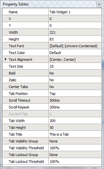

A table widget has the following editable properties in addition to the Basic Properties:
Reference Control Properties for instructions to configure each property.
