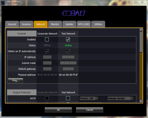

Be sure to check the {Enabled} check box for the Network Interface Connection (NIC) you wish for Cobalt to use. If you plan to use two NICs to communicate, check the {Enabled} check box for each. If your computer has more than 2 physical NICs, use the dropdown box provided above each column to select the two physical network interfaces you wish to use.
Status
This reports if the port is “Online” (configured, connected to a network and operational). It reports as “Offline” if any one of the above conditions is not true.
Automatically Obtain an IP Address
Note:  ETC recommends the use of a static IP address for compatibility with other ETC devices, though the needs of your particular installation may vary.
Clicking in the enable box will set your device to get its IP address dynamically from a DHCP server. While your device starts, it will ask for an IP address from a DHCP server. If one responds, it will use the assigned IP address.
If no DHCP server is available, your device will default to a self-generated link-local IP address in the range of 169.254.x.y. The IP address used by your device in this configuration may change dynamically as needed. A change should typically only occur when there are changes to the network configuration or to resolve an IP address conflict.
Enabling or disabling the DHCP setting will require you to reboot for the new setting to take affect.
Note:  You cannot set a device to receive an IP address via DHCP and act as a DHCP server at the same time. It can either send dynamic addresses or receive them, but not both at the same time.
IP Address
If DHCP is disabled, you set the IP address here. This is a static IP address and will remain set until changed by a user.
The following is a list of the default IP addresses:
If DHCP is enabled, this field will display the IP address that is being used by the desk (whether it is served via DHCP or a self-generated link-local IP address).
Subnet Mask
If DHCP is disabled, you set the subnet mask here. This is a static setting and will remain set until changed by a user. The default subnet mask is 255.255.0.0.
If DHCP is enabled, this field will display the subnet mask that is being used by the desk (whether it is served via DHCP or a self-generated link-local IP address).
Gateway
Note:  On Windows 7 devices, the gateway will be empty by default.
If DHCP is disabled, you set the gateway IP address here. This is a static gateway IP address and will remain set until changed by a user.
  • Recommended default gateway addresses:
    • Port 1: 10.101.1.1
    • Port 2: 192.168.1.1
If DHCP is enabled, this field will display the gateway IP address that is being used by the desk (whether it is served via DHCP or a self-generated link-local IP address).
Physical Address
The physical address is the MAC address. This address is a unique identifier and cannot be modified.

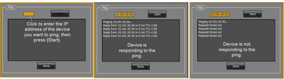

Ping
Ping is used to test the network connection between two devices.
