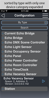

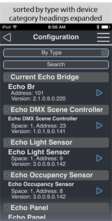

The Configuration page displays a list of all discovered devices in the allowed spaces of the Echo control system. All Echo devices can be controlled by the EchoAccess Mobile App, but not all discovered devices can be configured by the EchoAccess Mobile App.
Note:  Spaces that are set to Disallow for the selected interface will not display in the EchoAccess Mobile App.
Configurable devices display a blue arrow on the right side of the device name. Devices in the list with a duplicate address will indicate with a red exclamation point on the right side of the device name.

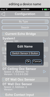

From this page you can also wink a device, both configurable and non-configurable device types, and change a configurable device's name from its default. Swipe left to access a device's wink and edit buttons.
