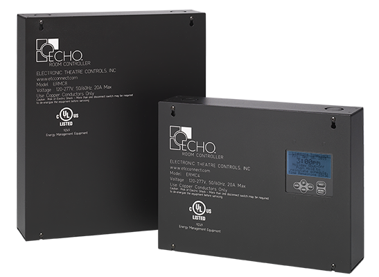

The Unison Echo® Room Controller provides a complete power solution for small- and medium-sized rooms - all from a single product. Its feed-thru power input allows all four or eight relay outputs and 0-10V control to be fed by the same input circuit or for any number of circuits to be separately fed.
Four Room Controller models are available:
- 4 Zone
- 4 Zone with integrated TimeClock
- 8 Zone
- 8 Zone with integrated TimeClock
