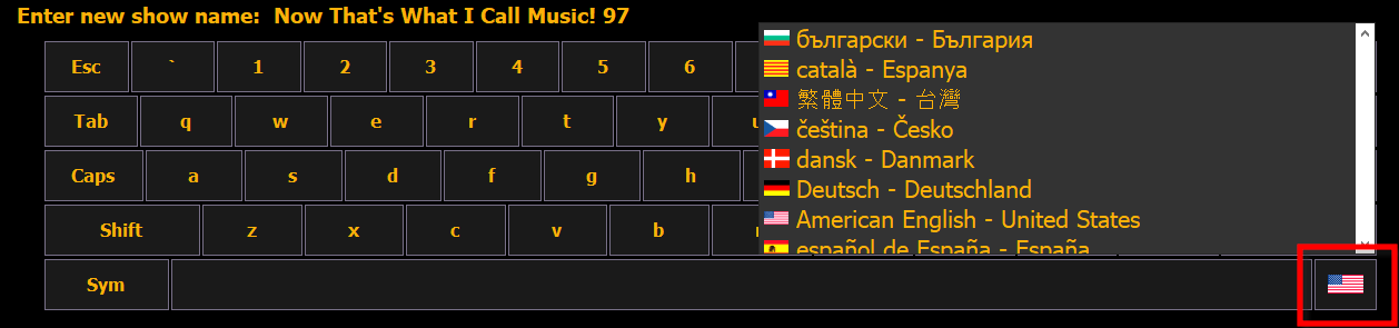

Keyboard
Allows you to select the language for the alphanumeric keyboard within Eos. A wide variety of keyboards are supported.
The keyboard can also be changed in the application when the virtual keyboard is open. Click on the flag icon to see a language drop-down menu.
Press {Sym} to switch the keyboard from alphanumeric to symbols. When in symbol mode, press {Abc} to return to the alphanumeric keyboard.

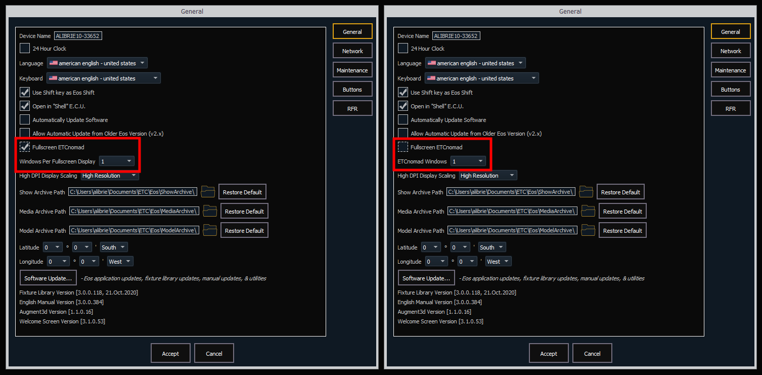

Fullscreen ETCnomad
Note:  This option is only available on ETCnomad.
When the"Fullscreen ETCnomad" box is checked, ETCnomad will automatically launch fullscreen, on all connected monitors of your computer. Select "1" in the "Windows Per Fullscreen Display" dropdown to show a single fullscreen ETCnomad display on each monitor, or "2" to subdivide each fullscreen display into 2 ETCnomad windows.
When fullscreen ETCnomad mode is disabled, ETCnomad will launch in a standard windowed display. The "ETCnomad Windows" dropdown allows you to choose to open up to 6 separate windows.

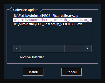

{Software Update...}
Allows the installation of Eos Family software and other ETC-approved software (Concert, UpdaterAtor, GCE, and NCE). Updating Eos Family software does not affect or update the software in any other networked device such as a Net3 Gateway.
When you click on {Software Update...}, the console looks at the root directory of any connected USB drive for an Eos Family console software update file. You will be shown the names of any updater files found on the drive. Select the file you would like to install and click the {Install} button, or click {Cancel}. The software will first save to the hard drive before opening the installer.
You will also receive a message if no software update file can be found.

{Software Update...} also recognizes .zip files provided by ETC, which contain fixture library files and other help packs for language or Augment3d content.
Fixture library update files are distributed as a .zip file, which can be installed on Eos Family consoles, ETCnomad PC, and ETCnomad Mac devices.
  1. Select the desired .zip file from the Software Update window.
  2. You will be asked to confirm that you want to install the selected file. Click {Yes} to continue or click {No} or {Cancel} to return to the Software Update window.
  3. A window will open showing the progress of extracting the .zip file. The installer will then launch after the file has been extracted.

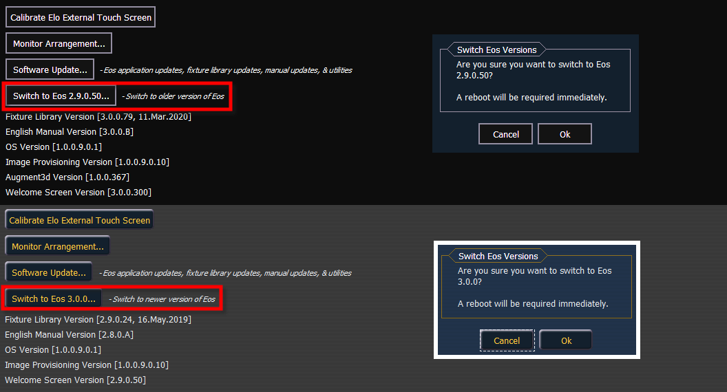

{Switch to Eos 2.9.x}
Eos v3.0.0 introduced the ability to switch between v2.9.x and v3.0.0 and later on consoles capable of running both. If v2.9.x is already installed, installing v3.0.0 or later automatically retains the 2.9.x version of software.
Use the softkey to alternate between versions. A restart will be required before any changes can take effect. This option is not available on Windows 10-embedded consoles.
Note:  If a console is updated to v3.0.0 or later from a version prior to v2.9.X, you will be able to revert from v3.0.0 or later to the prior version. However, you will be unable to return to v3.0.0 or later without first updating to v2.9.X.
