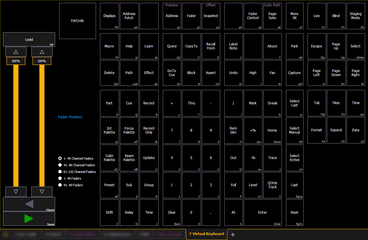

{Popup Virtual Keyboard}
Allows quick access to a keyboard which mimics the hard keys found on the physical face panel of a console. The alphanumeric keyboard shortcut for that hard key displays in the lower right hard corner.
The virtual keyboard is also available in a standalone tab via [Tab] [7].
