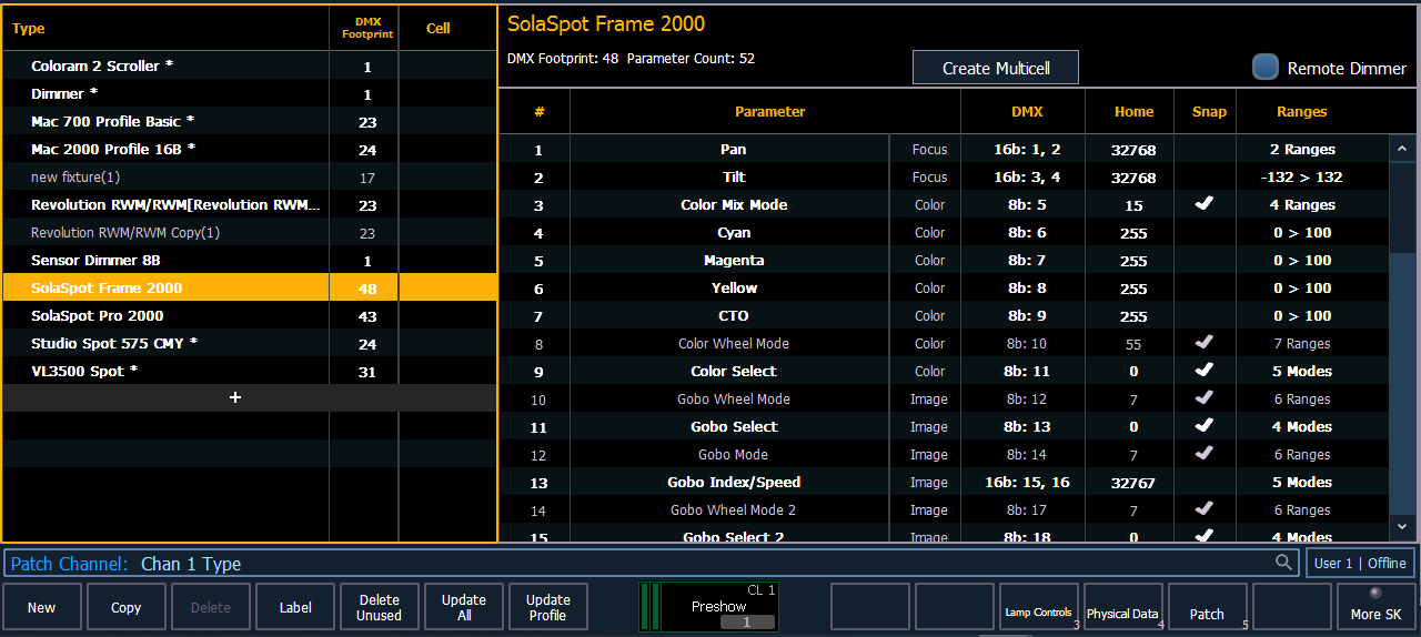

To open the fixture editor, open the patch display and press the {Fixtures} softkey. This will open a list on the left displaying those same fixtures that are currently patched or have been added to the show, and the list on the right are the parameters for the selected fixture.
