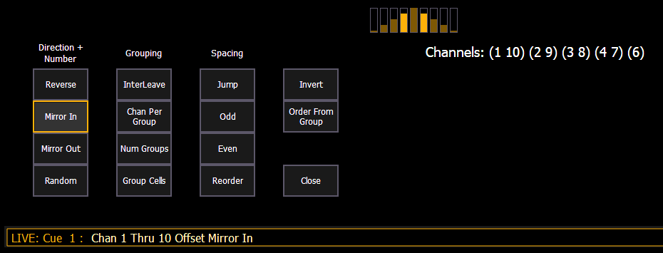

[Offset] can be used to select a range of channels from a broader channel selection prior to storing groups, submasters, presets, palettes, effects, and using park.
Options
When [Offset] is pressed, a channel distribution display will open.
The following options are available as extensions of [Offset]. Options can be used together. These extensions can be used to create Subgroups. To close the offset display, press {Close}.
Direction
- {Reverse} creates a group with the channels in the reverse order that they were selected in.
- {Mirror In} creates subgroups of channels that mirror inward.
- [1] [Thru] [8] {Mirror In} [Enter] would create 4 subgroups in this order: (1,8) (2,7) (3,6) (4,5)
Ch 1 | Ch 2 | Ch 3 | Ch 4 | Ch 5 | Ch 6 | Ch 7 | Ch 8 |
X | | | | | | | X |
| X | | | | | X | |
| | X | | | X | | |
| | | X | X | | | |
- {Mirror Out} creates subgroups of channels that mirror outward.
- [1] [Thru] [8] {Mirror Out} [Enter] would create 4 subgroups in this order: (4,5) (3,6) (2,7) (1,8)
