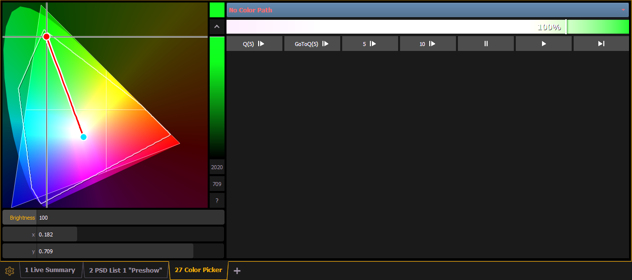

To open the color path display, click on the gear icon in the color picker display and select Fade. You can open the color path list display by pressing [Path] [Path]
Color paths are selected either by clicking on the drop down above the color path or by using [Path] [n].
Note: Channels involved in the fade have to be selected before you can choose or modify a color path.
The color path display has a drop down list of the available paths, a color path preview bar, and control buttons. An indication line will display on the color space to show the color fade.

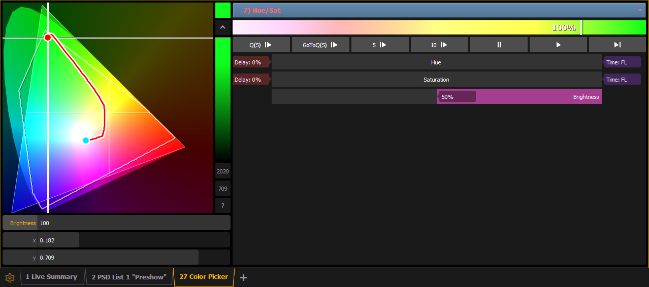

Additional controls may be available based on the color path selected. For example, Color Path 7 has additional controls for Hue, Saturation, and Brightness. You can move those controls to adjust the fade, and you'll see a representation of those changes in both the color path preview bar and in the color space.
