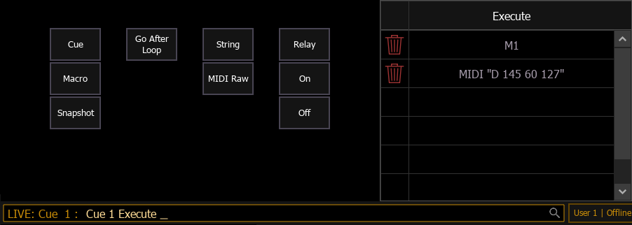

{Execute}
When used after selecting a cue on the command line, {Execute} will open a trigger display in the CIA.
Buttons for common targets are available on the left. These options are also available below as softkeys.
The table on the right lists all triggers associated with the selected cue, along with their reference labels. You can remove individual triggers using the delete icon on each line.
