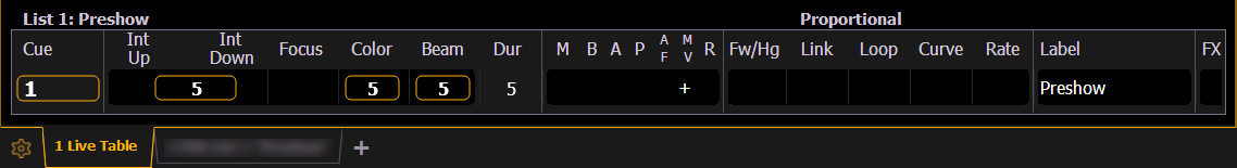

The attributes of the selected cue (such as timing, attributes, label and external links) are shown at the bottom of the Live / Blind display. For more information, see Assigning Cue Attributes.
