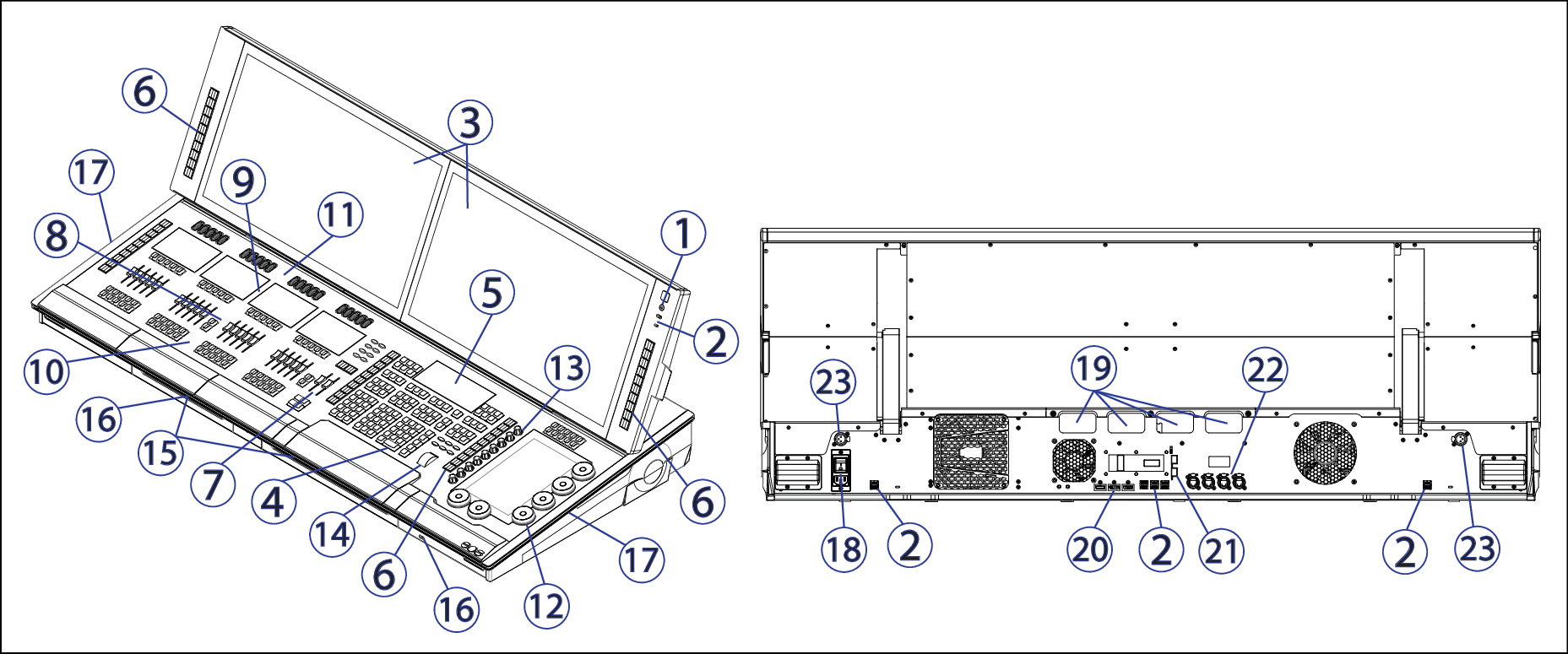

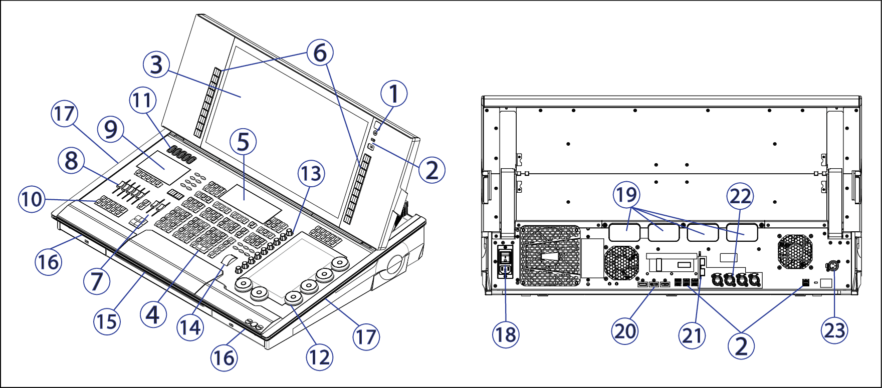

Eos Apex 20 Layout
  • 1. Power button
  • 2. USB-A & USB-C (data)
  • 3. Internal touchscreen
  • 4. Keypad
  • 5. Keypad touchscreen
  • 6. Target keys
  • 7. Main playbacks
  • 8. Motorized faders
  • 9. Fader touchscreen
  • 10. Configurable fader buttons
  • 11. Endless fader wheels
  • 12. Encoders
  • 13. Mini encoders
  • 14. Level wheel
  • 15. Keyboard / accessory tray
  • 16. USB-A (power only)
  • 17. Book lights
  • 18. Hard power switch / IEC socket
  • 19. IO garage
  • 20. Display Port
  • 21. SFP+
  • 22. Ethernet
  • 23. Littlite

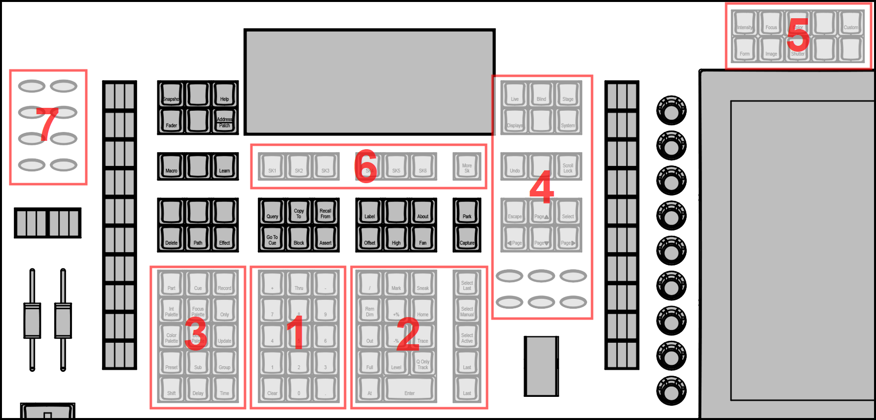

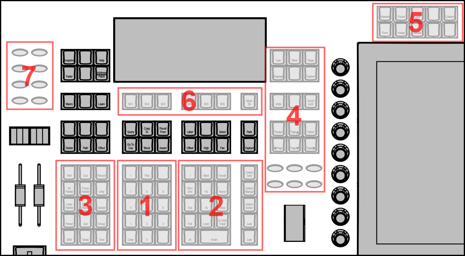

    Hardkeys
    Backlit hardkeys are provided on the face panel. The brightness level for those keys can be adjusted in the Brightness Settings.
    When your console has been idle for 10 minutes, the backlights will fade down by 10%. Any key press on the face panel keypad or an external keyboard, a move of the mouse, or an interaction with a touchscreen will return the keys to their set brightness level.
    The hardkeys are divided into several sections based on their functionality.
    Keypad (1)
    The numeric keypad allows you to type numbers for channel or target selection via the command line, along with modifier keys to alter your selection.
    Level Controls (2)
    The level controls provide options for altering the intensity levels of channels, along with a number of other non-intensity parameters / targets.
    Targets (3)
    The target controls provide options for altering a variety of record targets, as well as shortcuts to various Blind displays.
    Display & Navigation (4)
    The display and navigation keys provide quick access to common displays, formatting, paging, and navigation within displays.
    Encoder Categories (5)
    The encoder category keys allow navigation and paging of the main encoders.
    Softkeys (6)
    Softkeys allow control of context-based software options that change in response to the active display or command line syntax.
    Fader Controls (7)
    The fader control buttons provide additional options for easy local control of fader behavior.

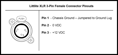

    Task Lights
    Littlites®
    You may connect Littlites to the back of your console.
