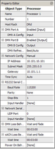

Processor Properties
Selecting a processor (Processor 1 for example) from the Browser displays that processors properties in the Property Editor.
- Object Type - the type / style of object you have selected. This property is not selectable or editable.
- Name - the name of the processor
- Number - the order in which the processor appears in the Browser unless a custom "User Sort" has been specified. This "Number" property can be edited, although you will be notified immediately by dialog if a processor number conflict occurs. Follow the dialog to continue.
- Host Rack - sets the rack type that the processor is installed into. Options include DRd and ERn.
- DMX Port A and DMX Port B- sets whether the selected port is enabled or disabled and reflects the I/O properties that were set for the processor ports in the New Project Wizard. DMX port configuration depends initially on the "Host Rack" specified for the processor. See "DMX A Config and DMX B Config".
- DMX A Config and DMX B Config - configure the "enabled" port as an input or an output. DMX port configuration depends on the "Host Rack" specified for the processor.
- DMX Refresh Rate - set the output rate of the DMX port. By default, this property is set to "Best/Auto".
Note: If DRd is specified as the host rack type for the processor, DMX Port B is set to "Output" and is not selectable for edit. DMX Port A may be configured for either an "Input" or an "Output" as needed for the installation. If ERn is specified as the host rack type for the processor, both DMX Port A and DMX Port B are selectable and editable. By default, Port A is set as an input and Port B is set as an output port.
- Network Config - displays network communication properties that were set for the processor in the New Project Wizard. From this property you can change the properties between "Automatic" and "Manual" configuration and specify the IP Address, Subnet Mask and Gateway as required.
- Time Sync - sets where the processors in the project will look to synchronize its clock for timed events, etc, using standard NTP time service. You can set each Architectural Control Processor individually to either "Server" or "Client" or "Auto". By default, this is set to "Auto". You can have only one "Server" per system. When set to "Auto", the first processor in the project (Processor 1) will be the default timeserver.
- RS232 Serial Config - set the baud rate, parity and stop bits for serial communication to the processor. By default, properties are 9600, None, 1 Stop bits.
- Input Handler - configures the handling of data received from the processor's local RS232 interface. By default this is set to PSAP (Paradigm Serial Access Protocol). Reference the PSAP Programming Guide . Up to 20 strings available. The PSAP Programming Guide is available on the ETC website at etcconnect.com.
- UDP Serial Config - set the UDP port for basic Ethernet communication to the processor. By default this setting is "0".
- Input Handler - configures the handling of data received from the processor's Ethernet interface for the purpose of receiving basic Ethernet control. Up to 20 strings available.
- ACN Serial Config - set the ACN port for ACN communication to the processor. By default the ACN Name is "ETC P-ACP".
- Input Handler - configures the handling of data received from the processor ACN interface for the purpose of receiving ACN and PSAP 2.1 control. Up to 20 strings are available.
- DMX Loss Behavior - sets the behavior for the processor when DMX input is lost. By default, this property is set to "Wait and Fade".
- Wait Time - the length of time the processor waits before fading when DMX is lost. This property is ignored when "Hold Last Look" is used as the DMX Loss Behavior.
- sACN Loss Behavior - sets the behavior for the processor when the sACN input is lost. By default this property is set to "Wait and Fade".
- Wait Time - the length of time the processor waits before fading when sACN is lost. This property is ignored when "Hold Last Look" is used as the sACN Loss Behavior.
- Power On Behavior - sets the action taken when power is returned to the processor after a power cycle. Many options available including "Channel Set Intensity", Group Set Intensity", etc.
- User Data - each object is provided with up to eight User Data Tags that can be used in object identification, such as Folders and Smart Folders filtering and spreadsheet sorts. These are labeled User Data 1, User Data 2, etc. by default, but the tags can be customized in the "Edit User Data Tags" option under the "Project Menu".
