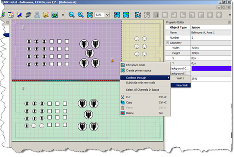

Combine Sub-spaces with a New Wall
Add a wall partition to combine and divide sub-spaces.
  1. Click within the Plan workspace, selecting the sub-space or select the sub-space from the Browser or Folders.
  2. Right-click in the sub-space and select "Combine through New Wall" from the context menu. The new wall will display graphically in the Plan workspace and in the Browser list (labeled Wall X) for the selected primary space.
  3. Click inside the Plan workspace to select the sub-space that you want to combine or select it from the Browser.
  4. Right-click and select "Combine through" and select the wall from the available options in the context menu. The wall will display graphically between the two sub-spaces in the Plan workspace. As well the Property Editor lists which "Combined Spaces" the wall affects.

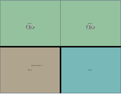

Display Combined Spaces
Click on the wall in the Plan workspace or select the wall from the list in the Browser or Folders. When selected, the sub-spaces that are combined with the wall are displayed with chain links to indicate the two spaces are linked.
When in the Program / Simulate view, double-click on the wall to toggle its state. When the wall is open, the combined sub-spaces will change to a matching background color, indicating shared control.

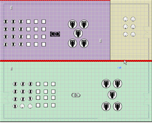

Add and Remove an Edge from Walls
It is possible to edit the length of a wall or make it appear on multiple edges of a space.

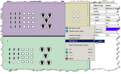

Add an Edge to a Wall
Right-click on the edge of the sub-space that you want to add an edge and select "Add edge to..." from the context menu. The graphic below displays adding an edge to Wall 1.

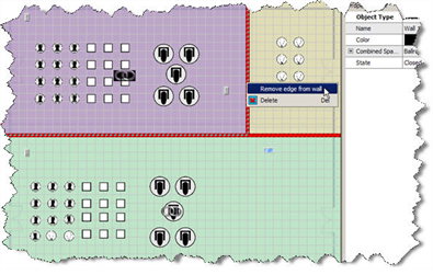

Remove an Edge from a Wall
Right-click on the wall edge to be removed and select "Remove edge from wall" from the context menu. The graphic below displays removing an edge from Wall 1.
