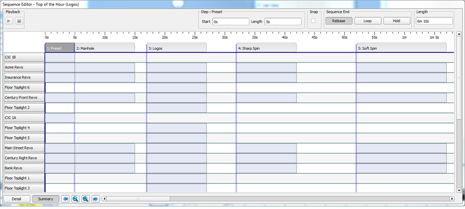

Sequence Editor
The Sequence Editor displays as a timeline view. You can build your sequence steps using existing presets and macros.

You may edit sequence step in the Editor Spreadsheet by selecting the step and viewing the Editor Spreadsheet or changing the properties in the Property Editor. You may also select the individual Sequence step in the Browser.
Using the Sequence Editor
With the sequence in Edit, you can change the settings of the sequence including, snap behavior, sequence end behavior and the length of the sequence.

View and Zoom
The Sequence Editor offers two view types, the Detail view and the Summary view.
Zoom buttons are available for increasing or decreasing the amount of time displayed in the Sequence Editor. From left to right, the Zoom tools include:
