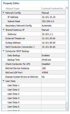

Selecting the Central Control Server from the Browser displays its properties in the Property Editor.
Note: A Paradigm Central Control Server (P-CCS) defaults IP settings of "Manual" with IP address 10.101.10.10, Subnet Mask 255.255.0.0 for the primary lighting interface.
Tip: If "Automatic" is the selected address method, Link Local IP settings are used when no DHCP service is found on that interface.
Note: This property defaults to 0.0.0.0, which means the Net3 Conductor Network Services Gateway is the NTP server. Configuring another IP address for this property instructs the P‑CCS to use a different external time server.
Note: With your Paradigm Central Control Server system, you cannot set or edit time related settings from the facepanel of the Paradigm Processor. Changes to timezone and DST must be made in LightDesigner. Matching changes to the Net3 Conductor configuration must be made in the Net3 Conductor web interface. See System Time for more information.
Note: All Paradigm products, by default, participate in Net3 logging (mainly for errors).
