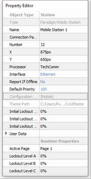

Selecting a Paradigm Mobile Station displays the properties in the Property Editor.
Type - the type of station you have selected. This property is not selectable or editable.
Name - the name of the station. Default is "Mobile Station X", where X is a number of the instance, beginning with 1. The name field is limited to 27 characters.
Connection Password - a user-definable password that enables connection of the Paradigm Mobile Station application to the Paradigm system.
Password can be up to 32 characters (numbers, letters, and symbols)
When connecting to the system, the password can be saved to the device for future connection by selecting the Save Password checkbox in the application.
Number - the order in which the station appears in the Browser unless a custom "User Sort" has been specified. This "Number" property can be edited, although you will be notified immediately by dialog if a station number conflict occurs. Follow the dialog to continue.
X & Y - the location (in cm) of the station in relation to the space it is located.
Note: 0,0 is the top left corner of the space.
Processor - the Paradigm Processor that the Mobile Button Station Application must bind to during system initialization. This field is a drop-down list of all available processors.
Default Priority - sets priority level for actions activated at station. The default priority is 100 and the allowable range is 1-200, where 200 is the highest priority. Lower priority control of an object will not operate if a higher priority control for the same object is active. This can be used to designate "more important controls".
Initial Lockout Level A, B, C - set the initial lockout level the station will use for each lockout group upon processor boot or project upload.
User Data - each object is provided with up to eight User Data Tags that can be used in object identification, such as Folders and Smart Folders filtering and spreadsheet sorts. These are labeled User Data 1, User Data 2, etc. by default, but the tags can be customized in the User Data Tags option under the Project menu.
Runtime Properties - displays the current “live” properties for an active station and its "Lockout Levels". This property is not selectable or editable.
Active Page - displays the active page for the station.
Lockout Level A, B, C - shows the current live lockout level for the station.
