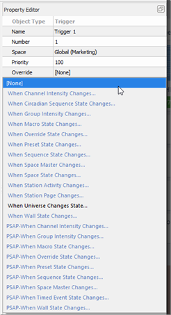

  7. Select the condition the Trigger responds to from the Function drop-down list. When a function is selected, additional properties display. Fully define the function according to the selection.
    Trigger Property Editor, Functions listing
    Note: Some function properties include an "Action" property. Actions can be set to any control function that can also be assigned to a control or fader. As you set the action, additional properties will populate for further definition. Be sure to completely define each provided action.
    Example: Setting a trigger function "When Channel Intensity Changes..." displays additional properties for the channel, including the upper and lower limits of the selection and a threshold setting from the limits. The additional properties that display are dependent on the function selection.
