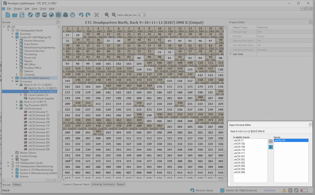

Use the Input Universe Editor to map available inputs to the selected output universe. This editor allows you to associate, for instance, local DMX port A input to local DMX port B output (this is configured by default). This editor also is used to create sACN gateways (DMX to sACN or sACN to DMX).

Add / Remove a Input Source from an Output Universe
  1. Click on an output universe in the Browser.
  2. View the available inputs in the Input Universe Editor.
  3. Add or remove an input universe using the Input Universe Editor:
