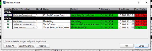

When the LightDesigner configuration file differs from the configuration on connected Paradigm processor(s) or Paradigm Central Control Server, the synchronization status will display as "Out of Sync" in the device list. Upload the current LightDesigner configuration to the connected Paradigm processor(s) using the [Upload Project] button in the Network view.
  1. Click the [Upload Project] button located in the Network view. The "Upload Project" dialog displays for processor selection.
  2. Note: Alternatively, from any view within LightDesigner Software, pressing CTRL+U switches to the Network view and displays the "Upload Project" dialog.
    Network View, Upload Project
  3. All connected Paradigm processors in the project will display selected for the upload.
  4. For projects that include one or more Echo Expansion Bridges, you can choose to overwrite the existing Echo Expansion Bridge configuration data with the project data in the LightDesigner Software configuration by selecting the "Overwrite Echo Bridge Config With Project Data" checkbox.
  5. Note: Selecting this checkbox overwrites the Echo Expansion Bridge configuration data only for bridges that are associated with the selected Paradigm processor(s).
  6. Click [OK]. When the upload process is complete, the processors that received the project upload will display as "In Sync" in the device list.
    Note: A dialog will display for any errors that require your attention prior to the upload. Follow the dialog to proceed with or cancel the upload process.
