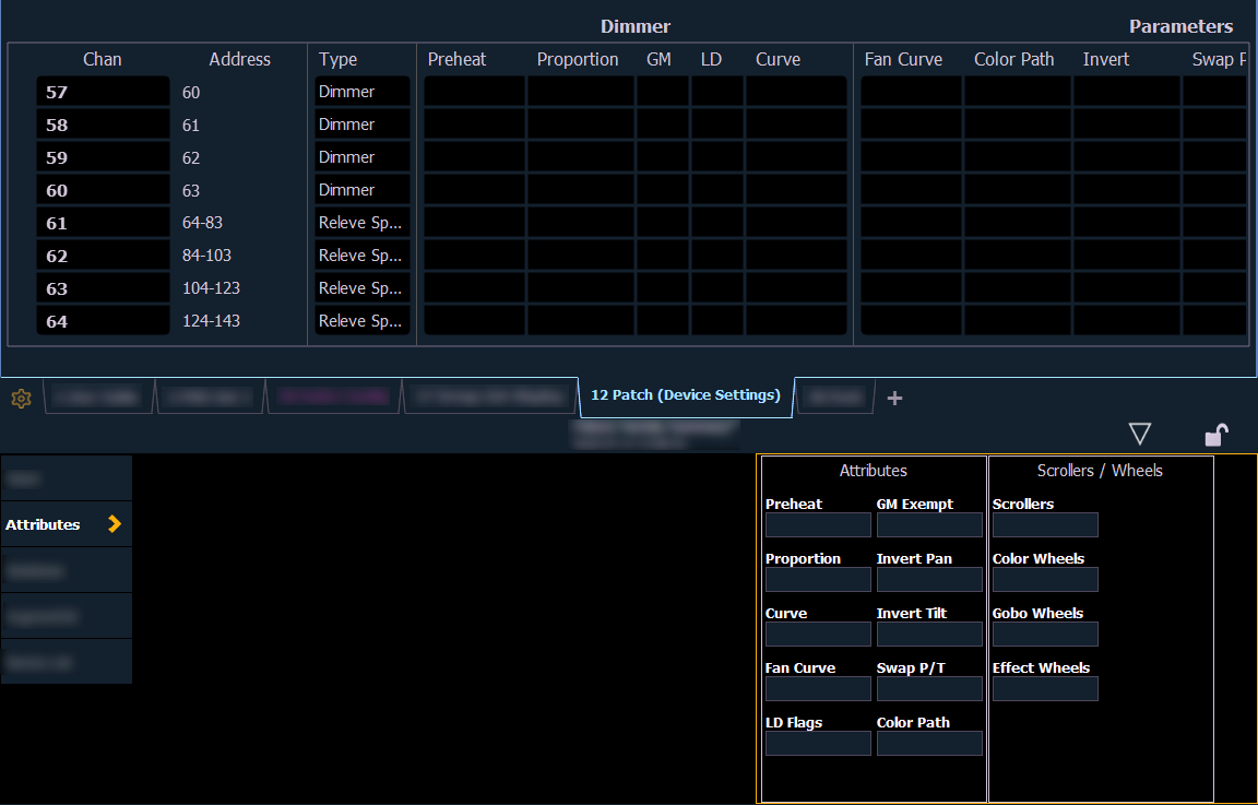

Patch > Attributes
The Attributes section provides you with optional fields for additional information and details about the configuration of your rig. Attribute settings include {Preheat}, {Proportion}, {Curve}, {Fan Curve}, {LD Flags}, {GM Exempt}, {Invert Pan}, {Invert Tilt}, {Swap P/T}, and {Color Path}.
With one or more channels selected, Scrollers / Wheels will display only the parameters that apply to those fixtures will appear. Press the desired attribute button and use the keypad to set the attribute value.

Note: When {Curve} or {Fan Curve} is pressed, a list of the available curves will be displayed. Clicking on an available curve will assign it.
