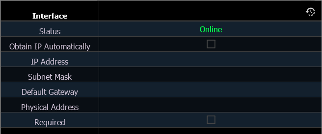

Status
A port is "online" in green if it is configured, connected to a network and operational. If any of those conditions is not true, it reports as “offline" in red.
IP Address
Allows you to assign a static IP address if "Obtain IP Automatically" is disabled. Select the field to open a pop-up allowing you to enter the address.

If "Obtain IP Automatically" is enabled, this field will display the IP address that is being used by the console (whether it is served via DHCP or a self-generated link-local IP address and subnet mask).
Subnet Mask
Allows you to assign a static subnet mask if "Obtain IP Automatically" is disabled. The default subnet mask is 255.255.0.0.
If "Obtain IP Automatically" is enabled, this field will display the subnet mask that is being used by the console (whether it is served via DHCP or a self-generated link-local IP address and subnet mask).

If "Obtain IP Automatically" is enabled, this field will display the gateway IP address that is being used by the console (whether it is served via DHCP or a self-generated link-local IP address and subnet mask).

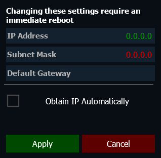

Note:  ETC recommends the use of a static IP address for compatibility with other ETC devices, though the needs of your particular installation may vary.
When enabled, this allows the console to request an IP address from a DHCP server during startup. If one responds, it will use the assigned IP address.
If no DHCP server is available, the console will default to a self-generated link-local IP address in the range of 169.254.X.X. The IP address used by the console in this configuration may change dynamically as needed. A change should typically only occur when there are changes to the network configuration or to resolve an IP address conflict.
Enabling or disabling this setting will require you to reboot the console for the new setting to take affect.
Note:  You cannot set the console to receive an IP address via DHCP and act as a DHCP server at the same time. It can either send dynamic addresses or receive them, but not both at the same time.
Physical Address
The physical address is the MAC address, a unique device identifier that cannot be modified.

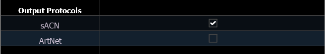

sACN
Enables or disables output of the sACN protocol.
ArtNet
Enables or disables output of the Art-Net protocol.

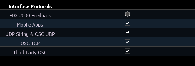

FDX2000 Feedback
Allows your console to receive FDX2000 dimmer feedback over the network. Disabled by default.
Mobile Apps
Enables or disables the connection of WiFi mobile RFR applications to Eos. Enabled by default.
UDP Strings and OSC UDP
Allows the selected port to send and receive UDP and OSC strings. Enabled by default.
OSC TCP
Allows the selected port to send and receive OSC via TCP port 3032. Select the OSC TCP format. Defaults to OSC 1.0.
Note:   Check the documentation for the OSC device you wish to use over a TCP connection to see which mode it supports.
Third Party OSC
Enables or disables dedicated server port 3037 for use with third-party OSC applications. Enabled by default.

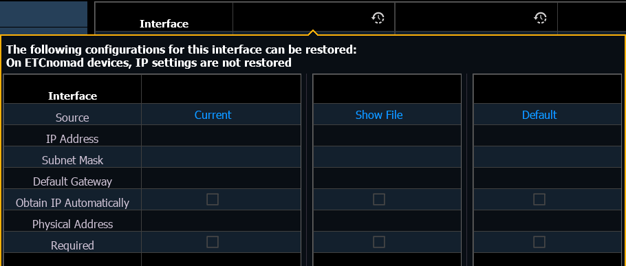

Restore Defaults
The Restore Defaults popup window.
Selecting the title header of each port allows you to access a restore defaults overlay, displaying a comparison of the current settings, those saved in the show file, and the defaults, allowing you to choose which to keep.
