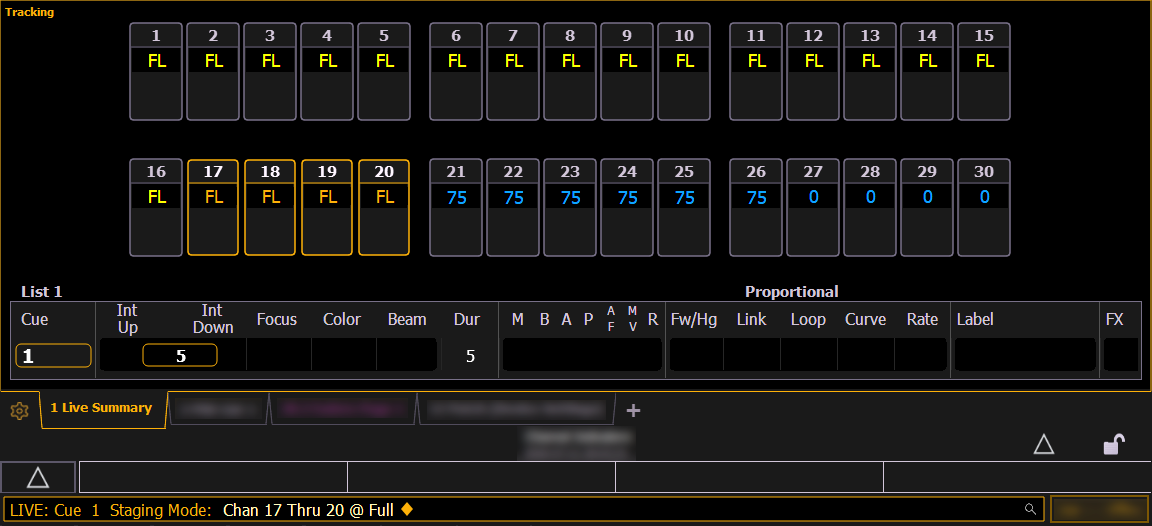

In either Live or Blind, enter Staging Mode by pressing [Staging Mode] or [Stage]. The command line will append "Staging Mode." Make the desired changes. Staged data will display in orange.

Press [Copy To] [Enter] to commit changes to either Live or Blind. Additional modifiers can optionally be added to the syntax (for example, [Copy To] <Sneak> <5> [Enter]).
Pressing [Staging Mode] or [Stage] again will place "Clear Staging Mode" on the command line. Exiting Staging Mode will preserve the changes without committing them. Staging Mode changes preserved without committing them are stored in a buffer for use when Staging Mode is reentered. If the buffer has content when exiting Staging Mode, the [Stage] key LED will blink.
Note:  Staging Mode changes committed to Live will display as manual data (red), and will still need to be recorded or updated into a cue.
