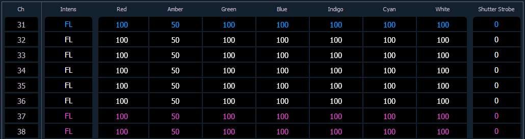

Editing By Type Presets in Blind
In Blind, the default channel’s levels will display in blue, discrete data for the other channels will display in white, and any channels that are using the default channel value will display in magenta.
