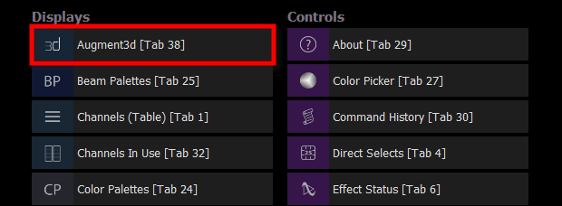

Either open a new tab and select {Augment3d} from the Displays list, or hold down [Tab] and type [38].

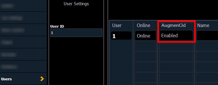

  2. On the console, enable Augment3d for your user number. In the CIA, navigate to Setup > System > Users.

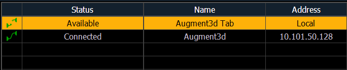

  4. Launch ETCnomad and select {Augment3d Tether}. Augment3d will launch in its own window, and try to connect to the console.
  5. Choose the correct tether device on the console (see Augment3d).
