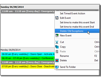

  1. To delete the old (expired) timed event exceptions, navigate to the Timed Events view.
  2. If the "Error Browser" is not displayed, select "Show Error Browser" from the Tools menu. If the Error Browser is shown, select the timed event error node or locate and select the timed event in the schedule.
  3. Right-click on the timed event in the schedule and select "Delete Old Exceptions" from the context menu. The expired exceptions will be deleted from the schedule. The Error Browser will update and that error for the selected timed event will be removed.
