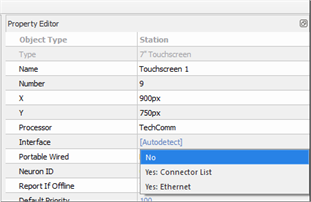

When using the 7" Touchscreen in a portable installation, you must select the type of portable installation for the space. With the 7" Touchscreen object selected in the Plan workspace, use the Property Editor to set the Portable Wired property for the 7" Touchscreen to "Yes: Connector List" or "Yes: Ethernet".
When "Yes: Connector List" is selected, you must add an instance of the Portable Connector (UH1RS) station and an instance of the 7" Touchscreen to each desired space of control.
