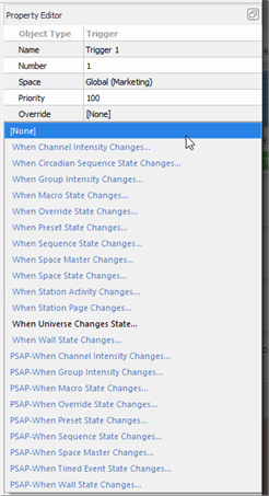

  5. Change the Trigger's priority level. The default priority is 100 and the allowable range is 1-200, where 200 is the highest priority. Lower priority control of an object will not operate if a higher priority control for the same object is active. This can be used to designate "more important controls".
  6. If the Trigger should be connected to a previously created Override, select the Override from the available options in the drop down list.
  7. Select the condition the Trigger responds to from the Function drop down list. When a function is selected, additional properties display. Fully define the function according to the selection.

    Example: Setting a trigger function "When Channel Intensity Changes..." displays additional properties for the channel, including the upper and lower limits of the selection and a threshold setting from the limits. The additional properties that display are dependent on the function selection.
    Note: You can specify a trigger to determine what happens when sACN is present or goes away, even when it has been patched in Paradigm. Paradigm processors will ignore their assigned Architectural Source (sACN) output when determining the sACN universe state. Select "When Universe Changes State…” and fully specify the properties including the universe, its action when active, and its action when it is inactive.
