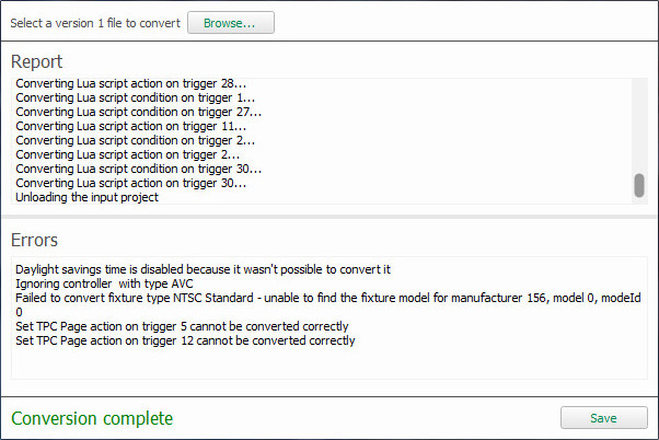

Project Upgrade Tool
The Project Upgrade Tool can import a v1.x.x file and convert it to work with Designer 2.5.x.
To use this tool:
- Browse to the v1.x.x file with the v1 Browse button
- Select the output location for the v2 file with the Browse button
- Press the Convert button
- The Report section will display the progress of the conversion and the Errors section will display any potential issues with the converted project file
- The Result of the conversion will be displayed at the bottom (Success or Failure)

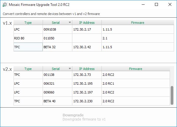

Firmware Upgrade Tool
The Firmware Upgrade Tool can be used to upgrade a controller with v1.x.x firmware to 2.5.x or to downgrade a controller with 2.5.x firmware to v1.12.
To use this tool:
- Select the controller or remote device that you want to convert (v1 or v2)
- Click the button at the bottom (Upgrade/Downgrade) and the firmware will be converted.
If a controller is displayed in grey, it cannot be converted either because it is on the wrong IP range, or the controller type is not supported by Designer 2.5
