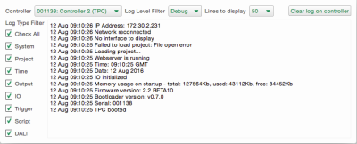

Select the verbosity (detail) of the log that can be viewed either via the web interface or from within Designer using the Controller Log Viewer in the Main Menu and selecting a Controller (which can be connected via Ethernet or USB):
Syslog
Check this to enable logging to the specified IP address. Note that there is a performance penalty to pay for using Syslog so this should only be enabled for debugging.
