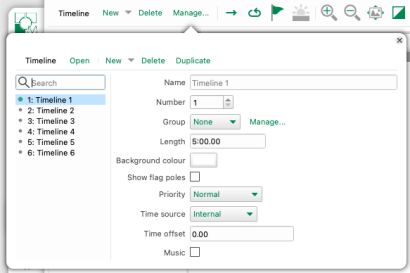

Timeline Properties
To change to properties of a timeline, select Manage... from the Timeline Toolbar. The dialog shown below will appear and you will be able to change the properties for the selected timeline/s.
Name
Give your timeline a name here, a descriptive name will help you identify the correct timeline when creating triggers and viewing the web interface's status and control pages.
Number
Every timeline has a unique number which is primarily for reference but can be changed if necessary. The timeline number is used to identify a timeline for creating triggers, for example when using LUA scripts, and when using the web interface's command line.
Group
The Group dropdown can be used to assign a timeline to a playback group. Clicking ‘Manage...’ opens a new popover where playback groups can be added, renamed, renumbered or deleted. Numbers and names must be unique. The number of playback groups is limited to 100.
See Actions for more information.
Length
The default timeline length is 05:00.00 (5 minutes) and you will need to increase this before placing or extending presets beyond this time. The maximum timeline length is 24 hours to prevent them becoming unmanageable - use triggers to stitch together multiple timelines to create longer time frames.
Background colour
Select the background colour of the timeline. Setting this to a colour that is not used within the timeline will make it easier to see some presets, e.g. a 255 intensity preset won't show up very well if the background colour is white.
Priority
Use the pull-down to select a priority level for the timeline. There are 5 priority levels which each feature an LTP+ timeline stack:
- High - the High Priority stack always plays above other timeline stacks
- Above normal
- Normal - the default priority
- Below normal
- Low - the Low Priority stack always plays below other timeline stacks
Time source
Use the pull-down to select a time source for the timeline to follow:
- Internal - the timeline will run autonomously although playback speed and position can be overridden using triggers.
- Real Time - the timeline will follow real time (see below)
- Timecode Bus - the timeline will follow one of the Timecode Buses (see below).
- Audio Bus - the timeline will follow one of four Audio Buses (see below).
Music
Enable tools for programming to music on the timeline. See Working with Music for more information.

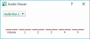

By selecting one of the four Audio Buses, the properties pane will give further options:
Band
The RIO A can generate up to 30 frequency bands (configured in Remote Device properties). Use this pull-down to select which band will drive the timeline.
Audio Buses
The four Audio Buses are internal buses to which one patches the external audio sources available to the system via one or more RIO As. You can use the Audio Feedback window available from the Main menu to monitor each Audio Bus:
