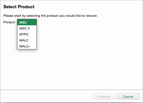

Controller Recovery
The Unison Mosaic Recovery Tool can be used to recover a controller if its firmware becomes corrupted, or in the case of the MSC X or Atlas/Atlas Pro, if the project file or settings need wiping.
The Controller Recovery Tool is a separate application to Designer. It is located:

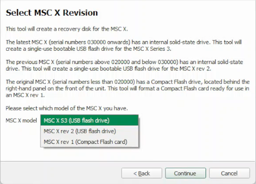

ClosedMSC X
The first thing to note with the MSC X is that there are two recovery procedures, with the correct procedure depending on the hardware revision in use. Select your hardware revision below to see the required recovery procedure.
Closed MSC X rev1

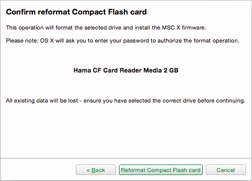

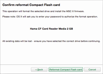

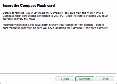

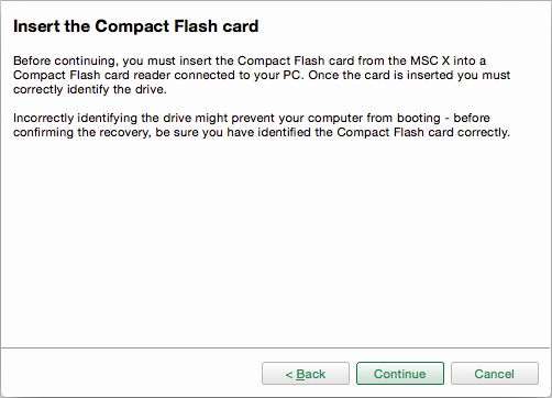

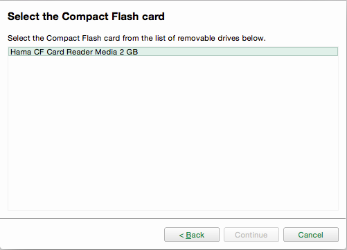

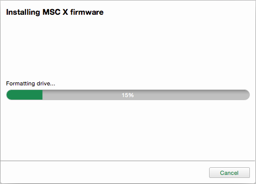

The MSC X rev1 contains a CF Card under the right hand front panel. This will need to be removed using a 2.5mm Allen Key, and the CF Card inserted into your computer (or a connected card reader).
Once you have connected your CF Card you will be prompted to choose it from your connected devices.
Finally choosing continue will reformat your CF Card with the correct firmware version
Closed MSC X rev2 & MSC X Mk3

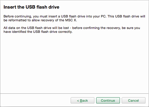

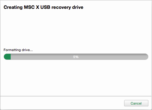

The MSC X rev2 & MSC X Mk3 can be recovered using a single use bootable USB memory stick, which is created with the rev2 option in the recovery tool.

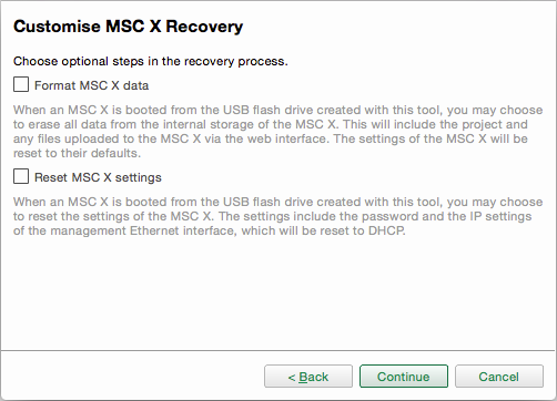

You will need to select which of the additional optional steps that you want to perform.

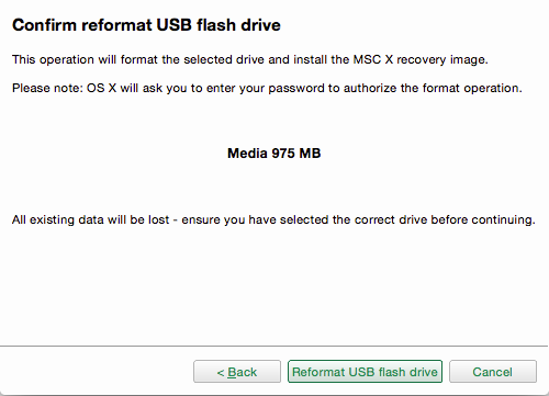

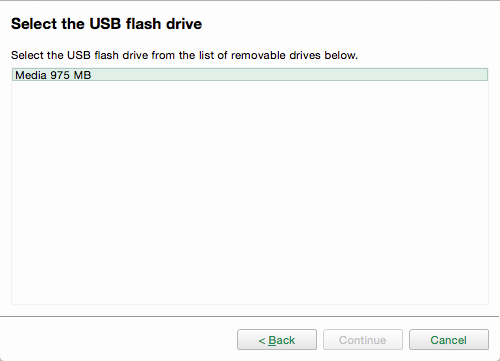

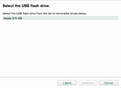

You will need to insert a USB memory stick into your computer. Bear in mind that the memory stick will be reformatted and all data wiped during this process.
Once you have connected your memory stick you will be prompted to choose it from your connected devices.
Finally choosing continue will create the bootable memory stick to recover the firmware on the MSC X and perform any additional steps that you selected earlier.
Additional steps:
