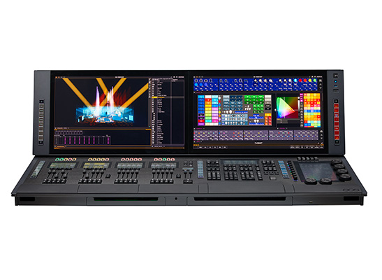

    Eos Apex Front
    Eos Apex 5, 10, 20

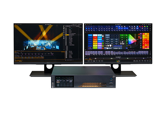

    Eos Apex Processor center light
    Eos Apex Processor

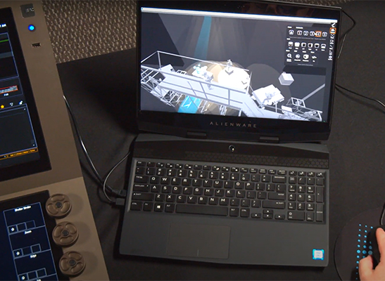

    Newer generations of Eos Family hardware can run Augment3d directly on the console, in a tab like other displays. Some older generations of Eos Family require Augment3d to be run on a computer networked with the console, called a “tether.” For more information about Tethers, see this support article.

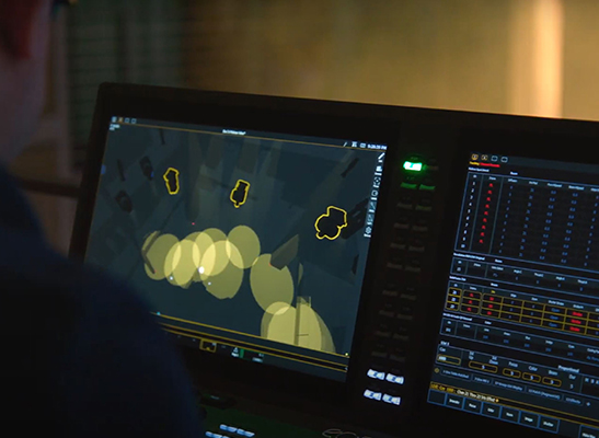

    Augment3d on console
    Augment3d running on the console
    Augment3d tethered
    Augment3d running on a tethered computer

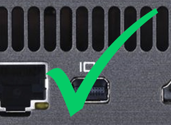

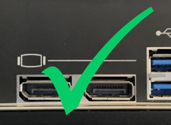

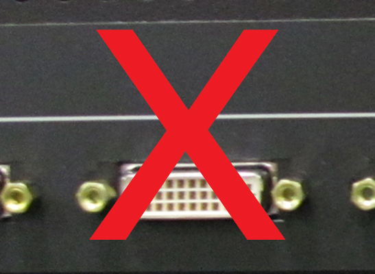

    An easy way to determine whether your hardware can run Augment3d directly on the console is to see if the device has at least one display port monitor output (full-sized or mini) on the rear.
    Display port
    display port (full sized)
    display port - mini
    display port (mini)
    DVI Port
    DVI port
    Eos Family hardware: Tether may be required to run Augment3d
    The following hardware have generations with DVI monitor outputs, which must run Augment3d on a tethered computer. Generations with at least one display port monitor output can run Augment3d directly on the console:
