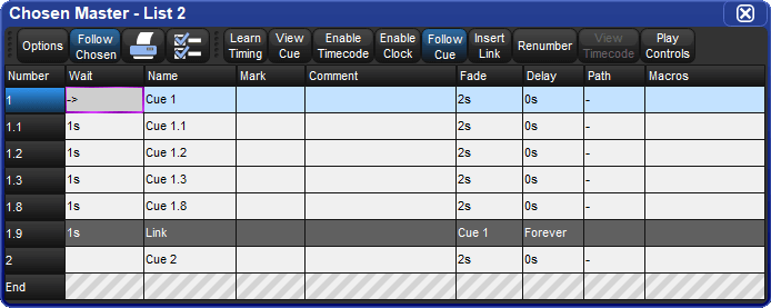

  1. Open + [Cuelist 1] : open the cuelist window.
  2. Play the cues in the list until the current cue (shown by -> in the wait column) is the cue before where you want the link.
  3. Click on the Insert Link button in the window. The link cue will be inserted after the current cue.
  4. Select the Fade cell of the link.
  5. Set [cue number] Enter : assign the cue number to be linked to.
  2. Select the link cue's Delay cell, and press Set.
  3. Select an option from the Loops Toolbar:
  4. Loops Toolbar
  5. If you have selected Count or Timed, enter a count or timed value.
