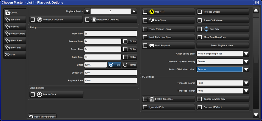

The priority, timing, and other various properties of a master that affect how it is played back are configured using the master's Playback Options window. This is the same for all master types (cuelist, scene, batch, group).

17.5.1 Master Timing and Rate Settings
You can assign several settings that control cuelist timing:

Release Time 2s
The time over which parameter values go to their default values when the cuelist is released; see Releasing Masters. Using the global option will refer the cuelist to use the global release time established in the show manager window under the show settings tab.
Assert Time 2s The time in which parameters go to their values determined by the cuelist when the cuelist is asserted; see Asserting One Cuelist Over the Others. Using the global option will refer the cuelist to use the global assert time established in the show manager window under the show settings tab.
Back Time 2s The time in which the cuelist steps back to the previous cue when the Pause key is pressed twice (to first halt the cuelist and then send it back). Using the global option will refer the cuelist to use the global back time established in the show manager window under the show settings tab.
Playback Rate
100%
Default proportion rate of the cuelist. A rate of 50% will double all cue timings, a rate of 200% will halve all cue timings.

17.5.2 Cuelist Wrapping
Wrapping decides what happens to a cuelist when it reaches the final cue. Configure the wrapping in the Action at End of List menu:

17.5.4 Action of go when Looping
When the cuelist is performing a continuous loop with the use of a link cue, you can configure the effect of pressing the Go key using the Action of Go When Looping menu:

17.5.5 Action of Halt when Halted
By default, pressing the Pause key when a cue is halted steps the cuelist back a cue in the assigned back time, see Master Timing and Rate Settings. You can change this action using the Action of Halt When Halted menu:
