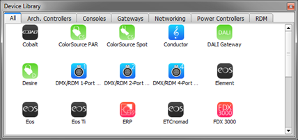

The Device Library shows devices that are known to ETC Concert; meaning the device package for that device has been installed and enabled using the Component Manager. Use the Device Library to add devices to the configuration which are not present on the network. For example, when you are configuring a system offline.

The devices in the library are organized into device categories, with each category being represented with a tab.
Currently defined device categories are:
- All: all devices from all categories
- Arch. Controllers: Paradigm Architectural Control Processor (P-ACP) and Paradigm Central Control Server (P-CCS)
- Consoles: Eos and Cobalt family consoles
- Gateways: ETC Gateways and Net3 Conductor
- Networking: Networks
- Power Controllers: Sensor+ rack, Sensor 3 rack, FDX 3000 rack, ERP
- RDM: RDM devices attached to ETC Gateways or the Gadget interface
