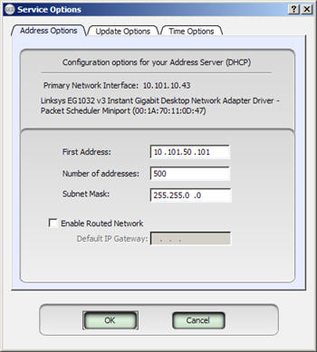

Clicking the [Advanced Options] button displays another dialog box which exposes properties of the various services and allows for further configuration as needed. Most lighting networks will not require editing of these property settings. More information of each property is provided below for reference.
These settings specify what IP addresses the Address Server (DHCP) gives out. Default settings are shown below.
"First Address:" specifies the first IP address that the Address Service will provide.
"Number of addresses:" specifies the maximum number of IP addresses that the Address Service will give out.
"Subnet Mask:" specifies the default subnet mask to be given out with IP address requests.
"Enable Routed Network:" specifies whether or not the system is configured to run on a routed network and what the gateway IP address is of the router on your lighting network.
