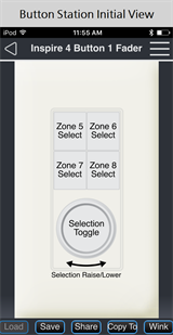

The General Configuration and Space Configuration pages also have a Wink button at the bottom.
To enable the wink feature for an Echo device from the main Configuration page, drag the device name to the left, revealing the Wink button.
Winking a device causes the device to respond by blinking its local LEDs, and for certain devices its connected loads, 8 times over 16 seconds. Wink will auto-clear after 16 seconds and return the device to its normal operation. Using the device's local UI buttons or asserting control during the wink cycle disables wink, restores the previous look, then fades to the new control values.
The individual device configuration pages for most devices also have a Wink button in the lower right corner.

Tapping [Wink] triggers all button LEDs on the station to blink.
