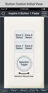

Tapping [Wink] triggers all button LEDs on the station to blink.
