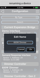

From this page you can also Wink a configurable or non-configurable device and Rename a device. Drag left to access a device's [Wink] and [Rename] buttons.

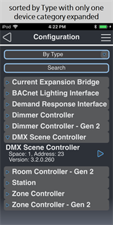

By default, the devices list displays its discovered devices sorted By Space then by the device address (e.g. all devices in Space 1, lowest address to highest, then Space 2, etc.). Additional sort options include By Address and By Type. Change the sort by selecting the option from the available drop-down list.
Sorting by type sorts devices into device categories that can be expanded and collapsed.
