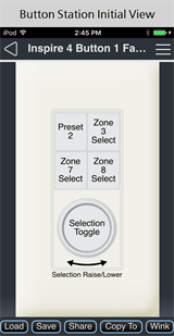

When you configure an Inspire button station with the EchoAccess App, a representative image of the selected station will display including labels for the currently configured button and fader assignments.
Tap on a button or fader control to configure its actions. The selected control's Configuration page displays. Configuration settings depend on the selected object type, either button or fader control.

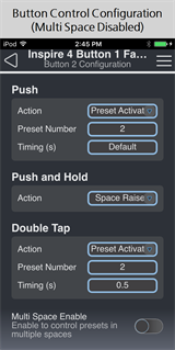

Button Configuration

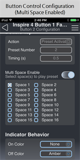

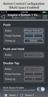

Use the available drop-down menus and keypad to specify the desired configuration information. Additional configuration options will display depending on the selected Action (e.g. if the Push Action is set to Preset Toggle, Preset Number and Timing(s) will display for additional specification). The Multi Space Enable switch will display if the Push Action is set to Preset Activate, Preset Toggle, or Space Off, allowing you to choose multiple spaces to which that action will be applied.
Note:  If Multi Space is enabled, the Push and Hold Action will be disabled and the Double Tap Action will be automatically configured.
Push
Use the drop-down menu to select the Push Action of a button or fader control.
  • Available actions includeClosed No Function, Preset Toggle, Preset Activate, Zone Toggle, Zone Lower, Zone Raise, Zone Set to Level, Space Off, Space Toggle, Space Lower, Space Raise, Space Set to Level, Zone Select, Selection Lower, Selection Raise, Selection to Level, Selection Toggle, Space Combine Toggle, Space Combine, Space Uncombine, Sequence Toggle, Zone Set to Color, Zone Set to Color Temp, Space Set to Color, Space Set to Color Temp, Timeclock Hold Toggle, Timeclock Hold Enable, Timeclock Hold Disable
Push and Hold
Use the drop-down menu to select the Push and Hold Action of a button.
Double Tap
Use the drop-down menu to select the Double Tap Action of a button or fader control.

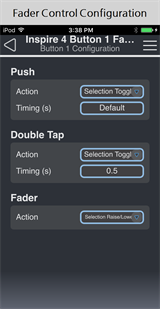

Fader Configuration
Use the drop-down menu to select the Action of the fader control (4 button and fader station only) when the fader is pressed, double-tapped, or rotated to the left or right.
Push
Available actions for Fader Push includeClosed No Function, Preset Toggle, Preset Activate, Zone Toggle, Zone Set to Level, Space Off, Space Toggle, Space Set to Level, Selection to Level, Selection Toggle, HSI Color Mode, Color Temp Mode, Studio Mode, Zone Set to Color, Zone Set to Color Temp, Space Set to Color, Space Set to Color Temp
  • HSI Color Mode is a three-way push control that determines the Fader Rotate action, cycling through Intensity Raise/Lower, Saturation Raise/Lower, and Hue Raise/Lower.
  • Color Temp Mode is a two-way push control that toggles between two Fader Rotate actions: Intensity Raise/Lower and Color Temperature Raise/Lower.
  • Studio Mode is a three-way push control that determines the Fader Rotate action, cycling through Intensity Raise/Lower, Color Temperature Raise/Lower, and Tint Raise/Lower.
Double Tap
Available actions for Fader Double Tap includeClosed No Function, Preset Toggle, Preset Activate, Zone Toggle, Zone Set to Level, Space Off, Space Toggle, Space Set to Level, Zone Set to Color, Zone Set to Color Temp, Space Set to Color, Space Set to Color Temp
Fader
Available actions for Fader Rotate includeClosed No Function, Zone Raise / Lower, Space Raise / Lower, Selection Raise / Lower, Color Zone Hue R/L, Color Zone Sat. R/L, Zone Color Temp R/L, Zone Tint R/L, Selection Hue R/L, Selection Sat. R/L, Selection Tint R/L, Selection Color Temp R/L
