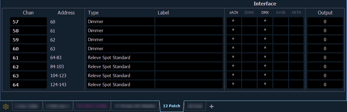

For patching fixtures, there are two different patch modes: Patching By Channel and Patching By Address. Eos defaults to patch by channel mode. Pressing [Format] while in the Patch display will toggle the mode between patch by channel and patch by address.
The main Patch display.
The patch screen will display the following information if available:
