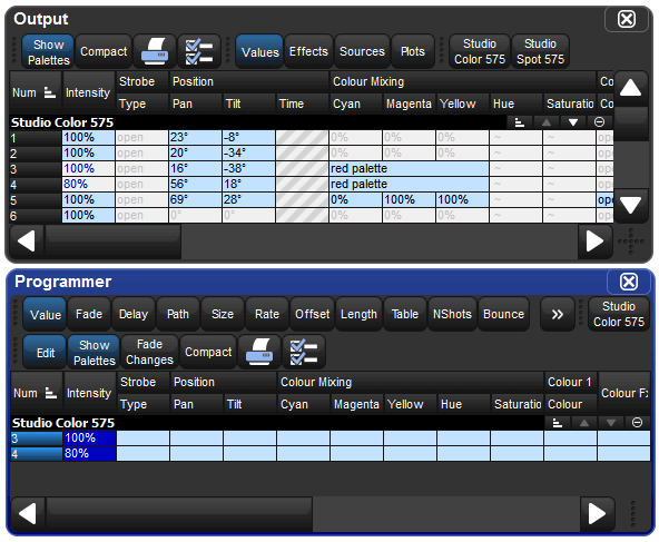

Similarly, you can apply this to palettes, scenes and cues, using the Live key to bring in fixtures and their parameter values that are on stage:
  • Live [Red Palette], Suck : fixtures on stage assigned to Red Palette are brought into the Programmer:
Fragment of Programmer and Output Windows, after using Live [Red
							Palette] Suck syntax.

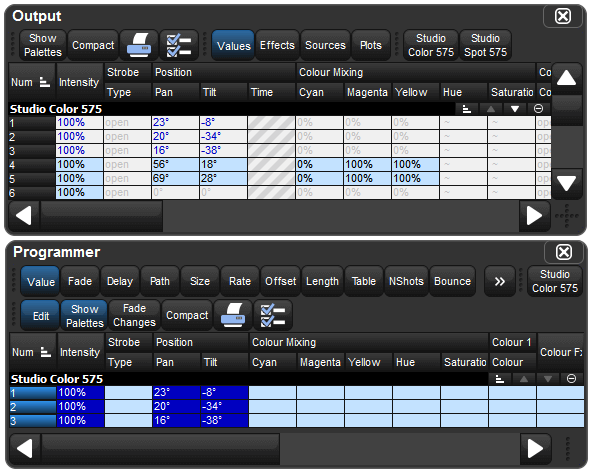

Or, you can use a mask to bring particular parameter type values from specific palettes that are on stage. For example, to bring the intensity values of [Red Palette] into the editor:
  • Live [Red Palette], Intensity Suck : the intensity values of fixtures on stage assigned to Red Palette are brought into the Programmer:
Fragment of Output, before using Live [Red Palette] Intensity Suck syntax.

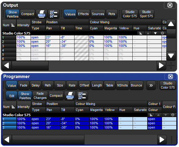

For example, if Studio Color 575s 1 to 3 are in the output with an intensity of 100%:
  • Live Touch : brings all the parameters of Studio Color 575s 1 to 3 into the Programmer, not just the intensity values (as suck would):
Fragment of Programmer and Output Windows, after Studio Color 575
							1-3 (at 100% in output) have been Live Touched.

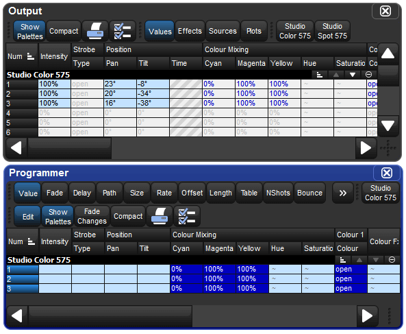

You can select the parameter types to touch:
  • Live Colour Touch : only the colour parameters are touched:
							1-3 (at 100% in output) have been Live Colour Touched.
