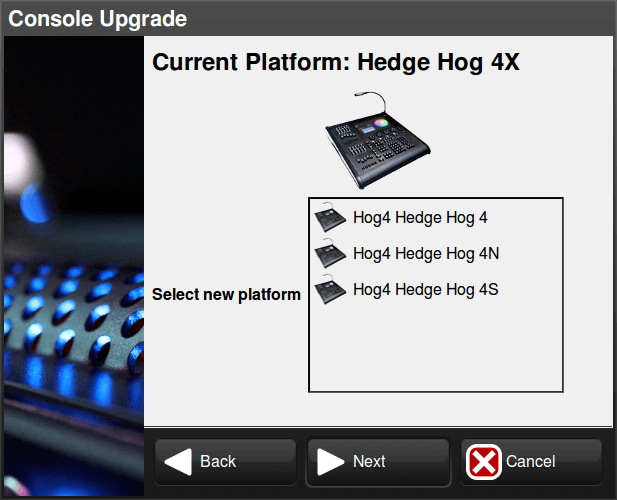

  4. Select the platform (model) you wish to upgrade to and press Next.
    Console Upgrade Utility step 2

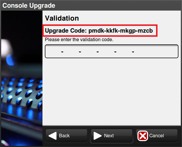

  5. Contact a High End Systems Sales representative and provide them with the upgrade code shown on the screen as well as which console platform (model) you are upgrading from and which console model you are wanting to upgrade to. The High End Systems sales representative will provide you with the current pricing for the upgrade and will process your order.
    Console Upgrade Utility step 3

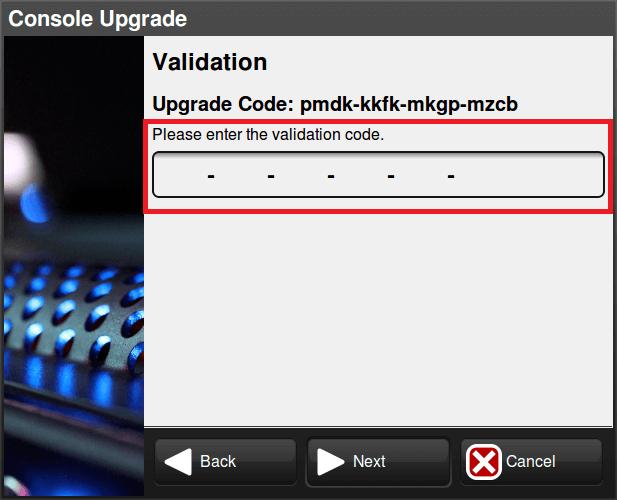

  6. Once your HedgeHog 4 upgrade order is complete, High End Systems will send you a validation code. Enter the validation code into the upgrade wizard and press Next.

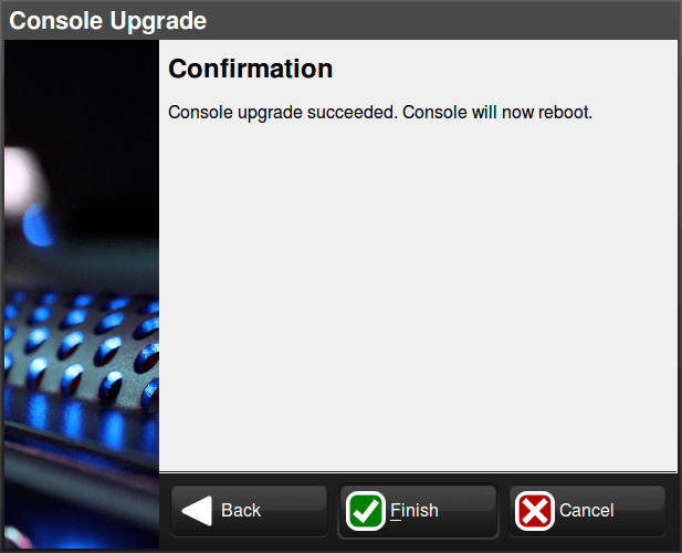

  7. Press the Finish. The console will now reboot and operate as the new platform (model).
    Console Upgrade Utility Finish.
