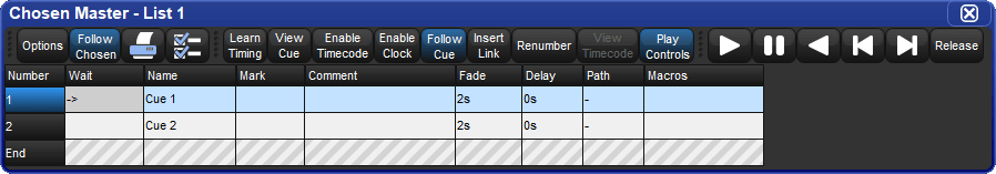

To run a cuelist, scene, or batch from the master window:
Open the master window for the cuelist, scene, or batch.
For example: [List 1], Open
Press the Play Controls button at the top of the master window. The on-screen playback controls will appear:
The controls are, from left to right, the Go, Halt/Back, Skip Back, Skip Forward, and Release buttons. These controls function independently from their front panel equivalents and always execute based on how they are labeled.
