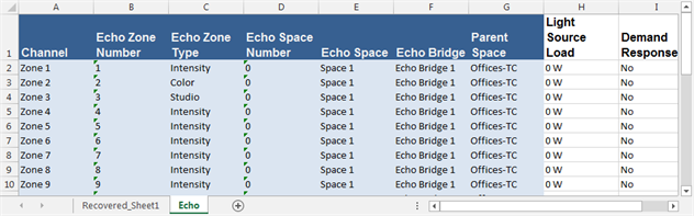

Echo Expansion Bridge
A second tab in the import load schedule spreadsheet can be enabled for Echo Expansion Bridge configuration data.
The data columns must include the following headers and supporting data for a successful import:
