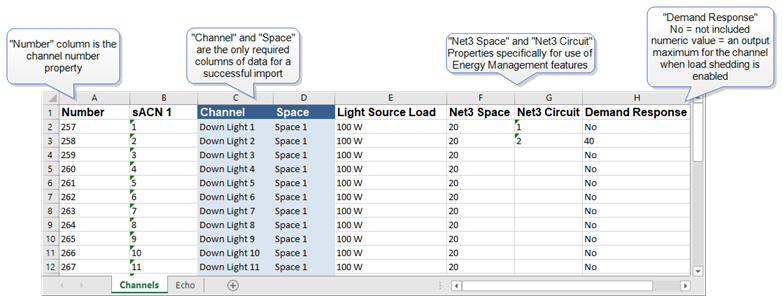

Example Exported Load Schedule
Exported Load Schedule Spreadsheet
The data shown in example above was exported directly from sample LightDesigner projects using the Projects > Export Data > Load Schedule feature. When viewing reports, any columns that are titled with parentheses, beyond the schedule samples above, are User Data Tags which are the custom column labels for any User Data that may be included with specific objects in your configuration.

In the example above, line 3, the load is set for inclusion in Demand Response and is set for an output maximum of 40%. This means, if a preset is active and that channel is set to 100% intensity, the load will be reduced to 40% intensity instead. If the channel is set to 35% intensity, Demand Response will not affect the channel's intensity level.
To include a channel in Demand Response using the Load Schedule spreadsheet, simply enter the maximum value in the Demand Response column for that channel.
