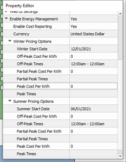

  1. In LightDesigner, select the Server Project from the Browser and set its Energy Management property to "Yes". Additional properties display for specification including Enable Cost Reporting, and Currency.
    Energy Management Cost Reporting Property Editor
  2. If you are interested in knowing the estimated energy costs for the calculated and measured energy data collected, request your local energy costs from your utility provider. With the Server Project selected, and the Property Editor in focus, set the corresponding Enable Cost Reporting property to "Yes" and complete the additional costing properties that display.
    Server Project Pricing Options Property Editor

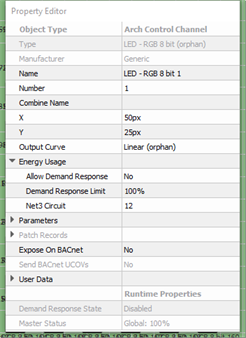

  3. Measured energy data - Compatible ETC power control products (e.g. Sensor 3 with Advanced Features) can be configured to report measured energy data to the Paradigm system.
    1. Using Net3 Concert software, identify each circuit in your compatible power control product and configure, then note, its Net3 Space and Net3 Circuit properties. These properties must match the Net3 Space and Net3 Circuit properties for the related channel configured in LightDesigner.
    2. In LightDesigner, select a space and set the corresponding Net3 Space property in the Property Editor. Both the primary and sub-space must have a Net3 Space configured (acceptable range is 1-255) in order to receive measured energy data.
    3. Select a channel in the configured space and review the Property Editor, expanding the "Energy Usage" property. Set the Net3 Circuit value for the channel to match the measured power control product.
  4. Note: Energy Usage properties are set on an individual channel basis.

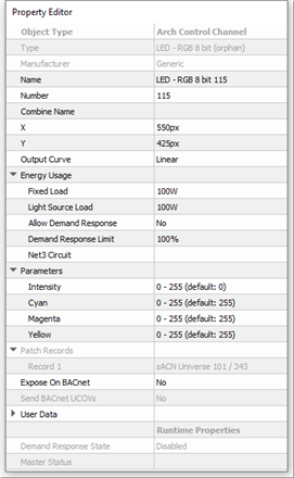

  5. Calculated energy data - Individual channels (circuits or loads) in your system that are not controlled by a measured energy power controller, instead calculate their energy data based on values that you configure. If your channel is calculated, supply the following Energy Usage properties:
  6. Note: An ETC fixture that was added from LightDesigner's Fixture Library will automatically populate its Light Source Load (and applicable Fixed Load) data. Load information must be specified for all other channel instances.
    Channel Property Editor
