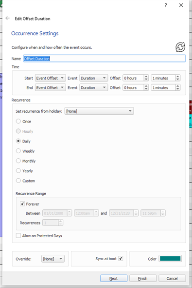

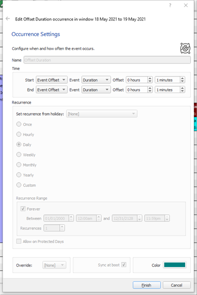

  2. Double-click on the event for the selected date to set an exception. Alternatively, right-click on the event and select "Edit Event" from the context menu. An "Edit Timed Event" dialog displays for selection.
  3. Edit Timed Event Dialog
  4. Click to choose "All occurrences" or "Only this occurrence".

    Note: Each recurring timed event displays with an icon next to the event in the schedule view. Recurring timed events that have exceptions display with a variation of this recurring event icon with a slash through the center, for easy identification of the events that have differences from the original parent timed event.
