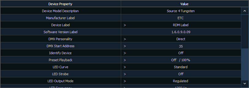

With a device or devices selected, you can edit various device settings in the property view, which will display in the CIA. Items with a caret (>) are editable. When multiple devices are selected together for editing, an “*” will show for data that is different between the selected devices.
The following buttons will also display in the property view:
